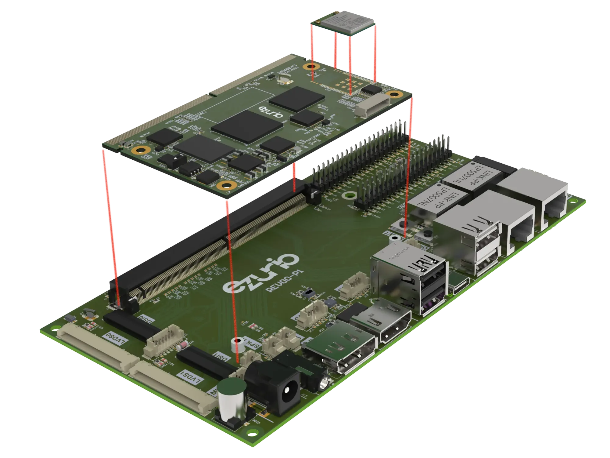

System on Module (SoM): This module has the CPU, the RAM, and the Power Management (PMIC), but does not have peripheral interfaces such as HDMI or USB. It is placed on a Carrier Board that is designed for a certain use in the industrial sector.
A Image showing SoM Ecosystem where a SiP ( A type of IC) is soldered on SoM (system on module) which is being placed on a carrier board.

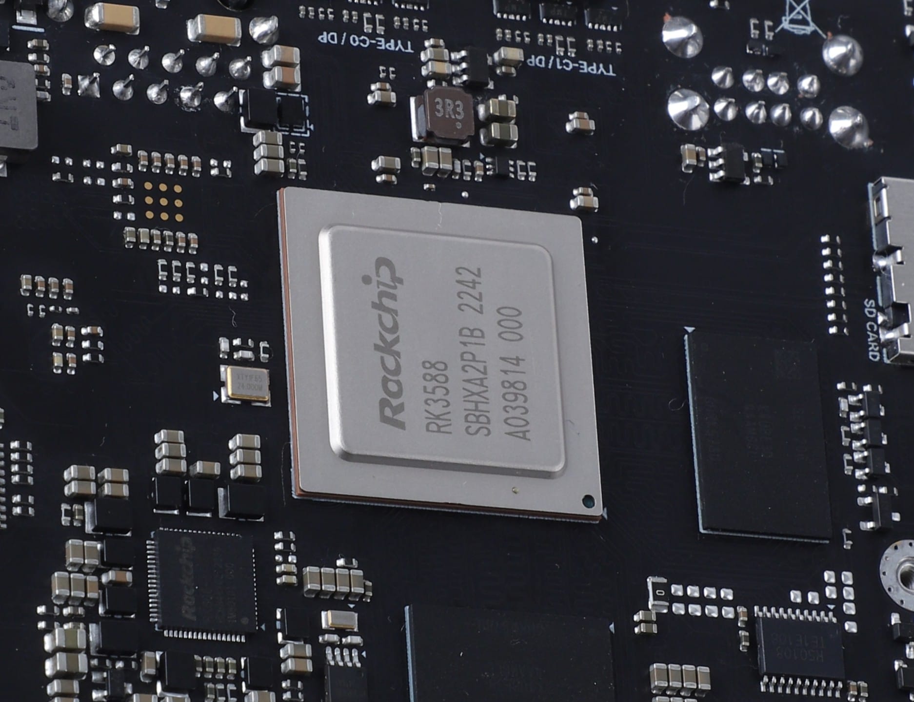

The processor is the actual brain of your computer. This part carries out almost all the operations you need to perform in your SBC and hence, becomes the most important factor for selecting a SBC. The criteria to select a processor is based upon its hardware and software properties namely Architecture, ISA, Cores and many more. Usually a higher number or core is many times related with higher performance but that’s not it. That is where architecture steps in.

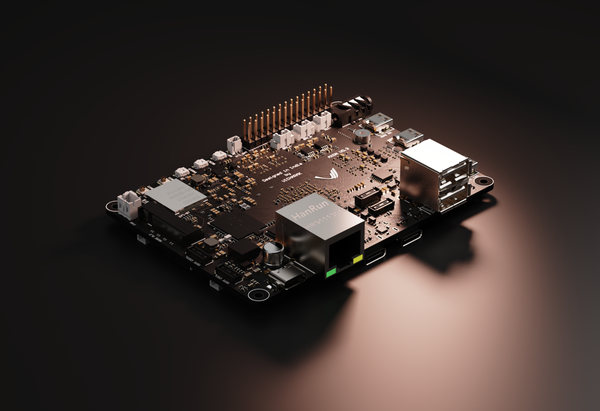

Vicharak's Axon SBC based on Rockchip RK3588 SoC
Architecture: When selecting, always aim for at least ARMv8 (which supports 64-bit computing) or higher, in order to support software such as Docker or TensorFlow. A modern lower-core CPU can any time beat a high core CPU with old or inefficient architecture.
To remove confusion and prevent you from digging more deep into CPU and its architecture, you can conveniently rely on Benchmarks. Look at actual benchmark results for IPC performance as well as the ability of the chip to support the flow of data between the CPU and memory.

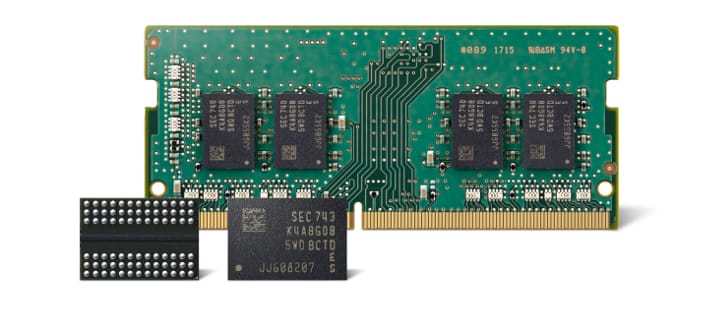

For example, think about your RAM in terms of your work desk. If your work desk is too small, your CPU has to work too hard, which slows it down.
A DDR4 DRAM and a SODIMM stick based on same DRAM.
Image Courtesy: Samsung.com
Selection Criteria: For “Headless” servers, which lack the monitor, 1GB–2GB is adequate whereas Desktop or AI applications require at least 4GB. But make sure to check for standards (DDR5, LPDDR4(X), LPDDR5(X), etc.). DRAM of higher standards provide faster speeds and lower latency, which is necessary for applications that utilize memory heavily, such as video processing.

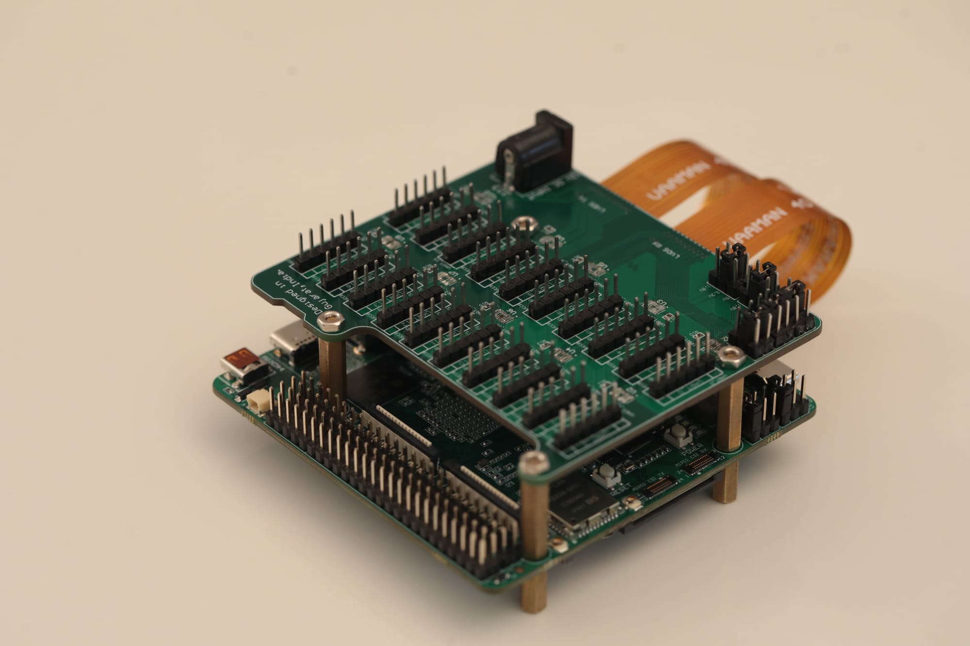

Hardware Interfaces enable your SBC to “talk” to the physical world.
Low Speed I/O: On the low-speed I/O, common interfaces include I2C, UART, SPI, and GPIO for interfacing with sensors and modules.
High-Speed I/O: Having a PCIe interface is a HUGE plus. This lets you connect external SSDs or AI accelerators.
Ecosystem: It is a good sign if your SBC manufacturer provides HATs (Hardware Attached on Top) or shields so you won’t have to make your own custom boards for particular applications. Some companies can also design a custom HAT upon request for your specific needs making you avoid hassle to design on your own.
Vicharak's Vaaman and its GPIO expander HAT.
